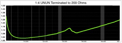

How to measure the AL value (inductance factor), and the initial µ0 (initial permeability), is a subject of another article, so I am not going to get into details here. I located a ferrite toroid with 1.1-inch (2.9 cm) outer diameter, more than enough for the relative low power operation with a KX3. I determined that its parameters are around AL = 450 and µ0 = 550. It is somewhere between ferrite material 61 and 43. I wound seven bifilar turns of enameled wire, protected by an insulating tube on the toroid, and then measured its SWR. As the diagram shows, it is quite low across the entire HF frequency spectrum. For my intended band usage: 40m, 30m and 20m, the SWR is under 1 to 1:04. I could not expect any better than this.

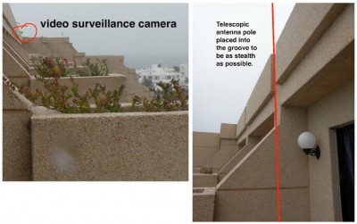

The second day after settling in the hotel, I surveyed the balcony and the surroundings for the placement of the antenna. To the left of the balcony was a video surveillance camera, so I decided to install the pole in the evening, perhaps the camera’s vision is reduced, as well as nobody will be outside the hotel grounds to see it. The right side of the balcony had a grove on top of the building side, where I could slide the antenna pole to be out of the sight of the camera. The following pictures demonstrate the placement of the antenna; however, I could not take pictures during the evening, therefore it is only illustrated with a red line.

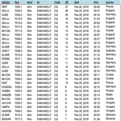

Later I examined the Reverse Beacon Network (RBN) reports to see who heard me. This table is sorted according to the signal strength. There were quite a few RBNs, that heard me with reasonable signal strength.
